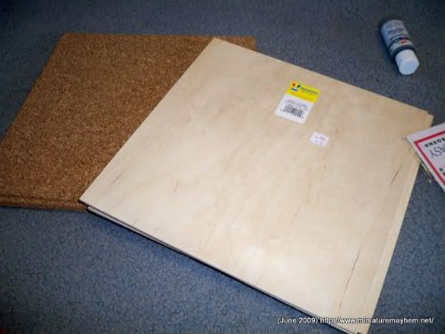

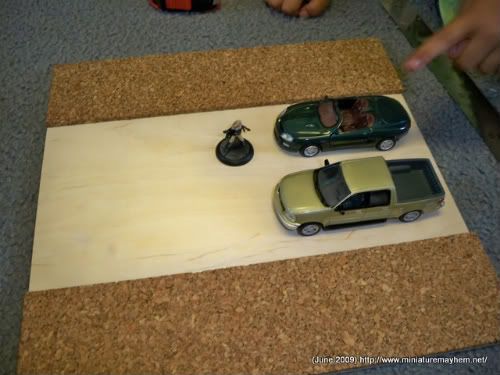

For a base I use a 12" x 12" plywood. I bought 4 to make a 2 x 2 play area. Perfect for a low level encounter. Cost: $10 for 4.
For the sidewalks I bought 12" x 12" cork board which I cut into strips of 12" x 3" for each end of the board. I glued this on with wood glue. Cost: $5.00 for 4.

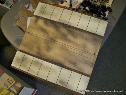

Next I bought some gridded poster board for the top of the sidewalks. I glued this on with super glue. Cost: $2.00 for a 5 sheets.
I then used texture spray paint over the whole thing and then primed it black. When it fully dries I will start painting.
I'll post updates as I go along.

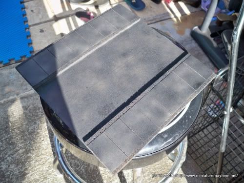

Here's a little update.
PostPosted: Wed Jun 17, 2009 1:35 pm
Looks very effective. Very inspiring.

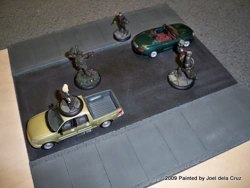

I created a 2' x 2' board to use for Gen Con using cork tiles and 5" wide one-way crossroads. Might I suggest for the road itself, Rustoleum dark grey textured spray paint. I used it for my roads and it is the perfect color and the perfect amount of texture. I don't have any pics of the board yet, though.
