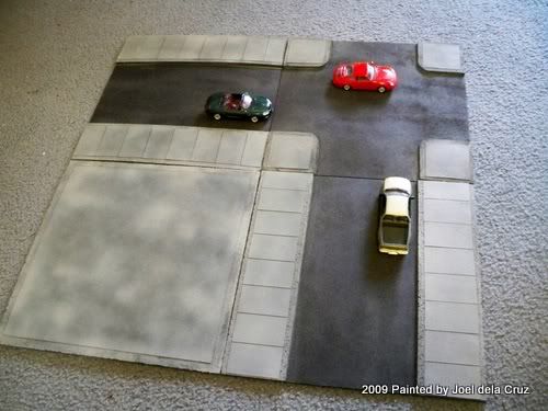

Here's an update.
2 x 2 play surface is finished.
Next I will work on the street lines and then the building for the open lot. After that I will work on some street lights and some accessories such as bus bench, trash cans and phone booth.

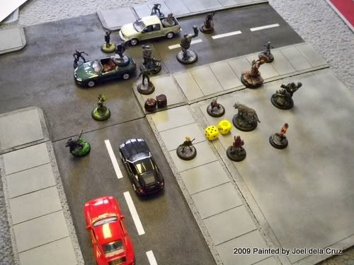

Here's a quick update.
